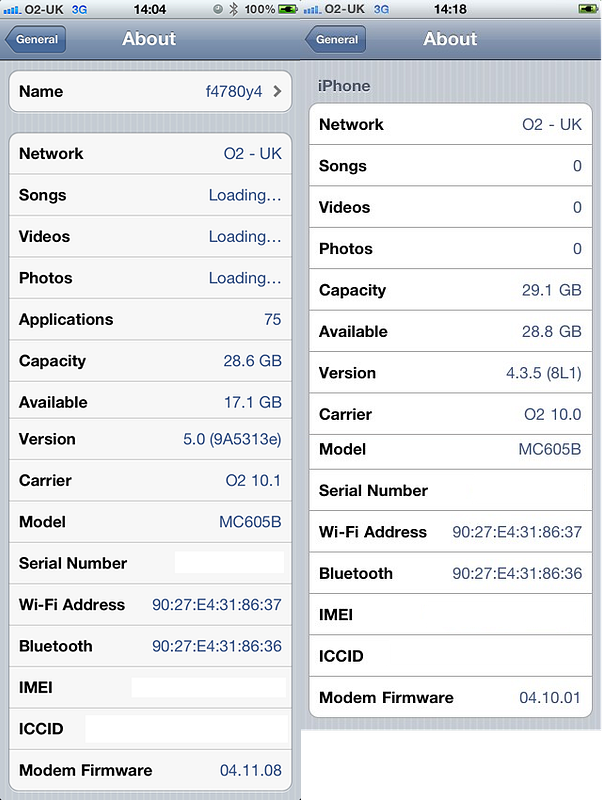

Here are my before and after "About" screenshots showing that the baseband was downgraded (as well as the differences in About screens between the versions!).
Remember, the baseband cannot normally be downgraded, however because Apple are signing both the beta and current firmwares, and their associated basebands, it is possible, but only until the official release of IOS5.
