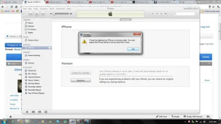

after using iBooty as well it gives me this same message on iTunes.. :'( $Untitled.webp
Hold down home+power for 10 seconds, then release both, wait a second or two and then hold down just the power button and the Apple logo should pop up. This time use Redsn0w to put your device into Pwned-DFU mode, iReb has lots of issues. Also you said you were trying to restore 5.0 which is not possible. You MUST make a custom 5.0.1 firmware and restore that.
