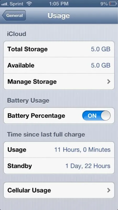

My iPhone 5 was having poor battery life I let it run down and it shut off at 10% recharged and now battery life is back to normal.
Is there a point to that statement? If you are saying you conditioned your battery you are not reading the thread. What we learned was that dropping the battery down to 10T conditions the OS. If you think otherwise then you should read the entire thread. Skull has also put a link to dresearch tat explains how this works.
