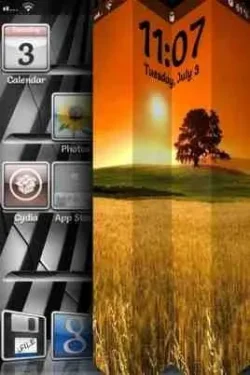

The Unfold tweak is found under the address /Library/Application Support/Unfold. To theme it, I put two transparent PNG images into a Winterboard theme - the theme address being: YourThemeName/Bundles/de.maxner.unfold/slide.png (and/or slide@2x.png).
Here's a pic to show my Unlock tweak in action - with no slider and no text:
