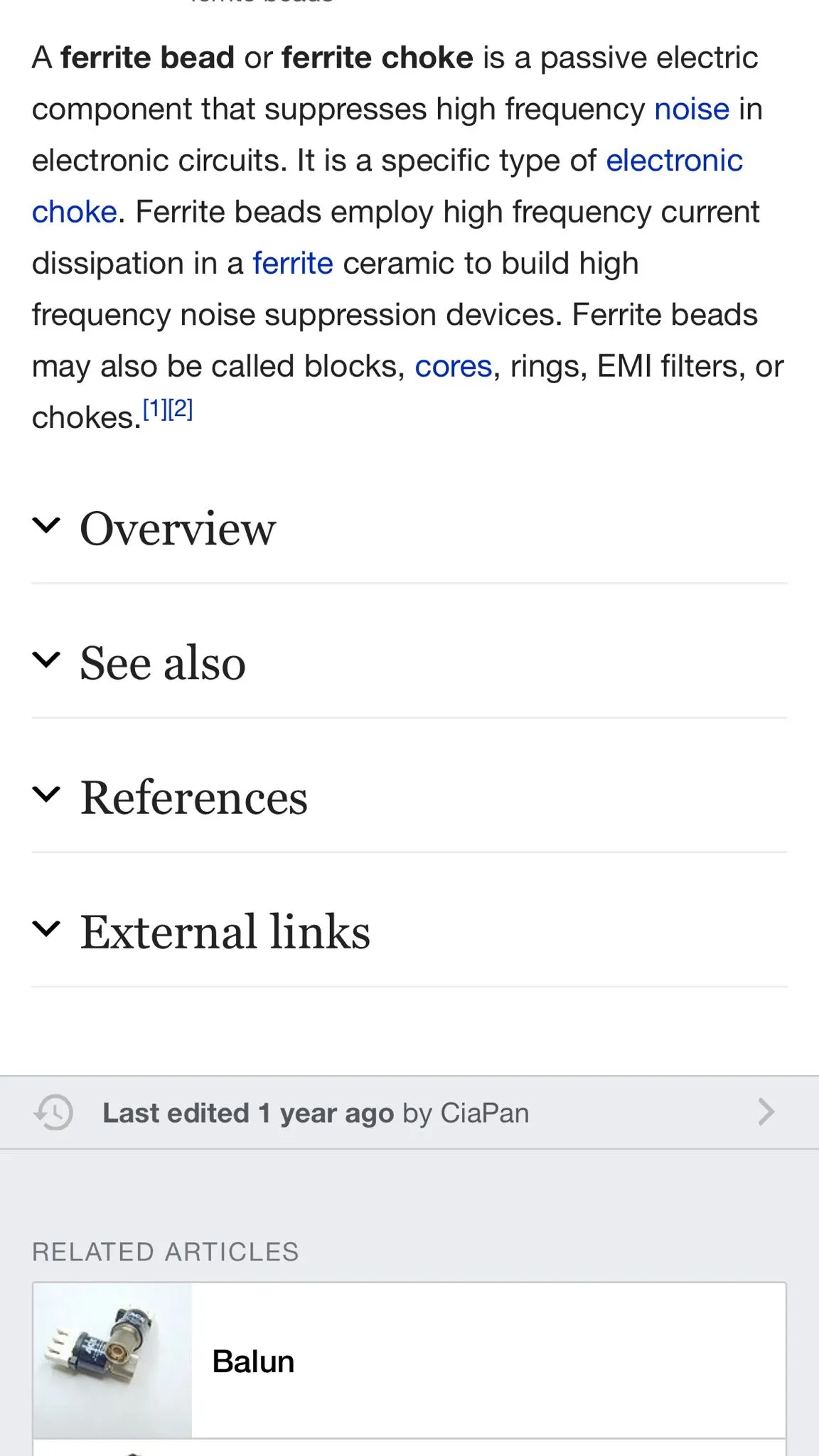

Here is some more info on ferrite chokes.
Here is a good article.

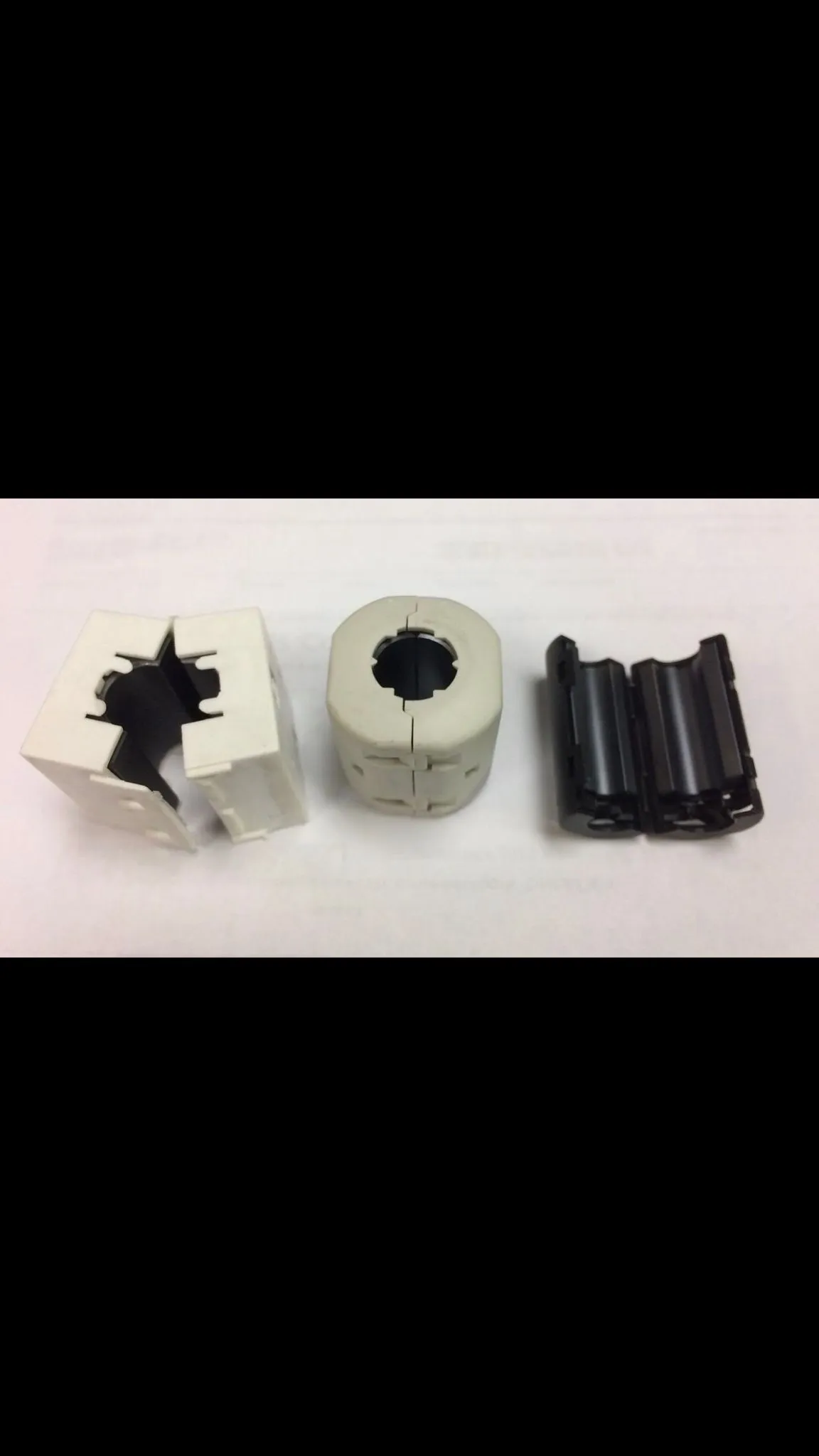

Example of typical small- and large-diameter ferrite cores

Typical placement of ferrite core around small-diameter cable. Note small piece of gaff tape wrapped around cable for a more snug fit to keep the core from sliding around
Ferrite chokes are passive devices that selectively block or dissipate high frequencies traveling through a cable. You might think of them like electrical toll booths, allowing audio frequencies to pass through while keeping radio frequencies out. There are lots of different kinds of ferrite chokes, some of which are expensive, finicky, hard to install and poorly suited for suppressing GSM frequencies, which may be as high as 1,800 MHz.
