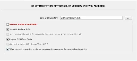

Start TinyUmbrella, switch to the "Advanced" tab, and UNTICK the option which says "Set hosts to Cydia on exit".
You can see the option, which is the second check box in the list, in the following screenshot:
Once you have unticked the option you are done. Just exit TU and your hosts file will be back to normal and pointing towards Apple. This is the best way to leave it. If you need to restore using TU in the future, just press it's "Start TSS Server" button. You never need to change the hosts option again. Just leave it switched off and TU does the rest.

I am interested in updating my iphone 3gs and facing the problem of 3194 error. While following your tutorial, I am experiencing a problem. i.e I am seeing the attached screen shot being unable to uncheck the "Set Hosts" option. Please help$tiny umbrella.webp
Remove any Apple hosts from your host file, and delete the host.umbrella file in the same directory as your host file. Then flush your DNS and retry.

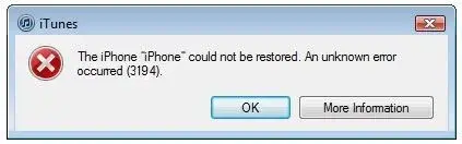

What does the error specifically say.
I get a pop-up exatly like this:
I tried the basic: the host file, but there was no references to apple, in fact there was nothing without the "#"
I tried with 11.05 itunes (64bits) and then I roll back one version just to be sure, but the error remains.
