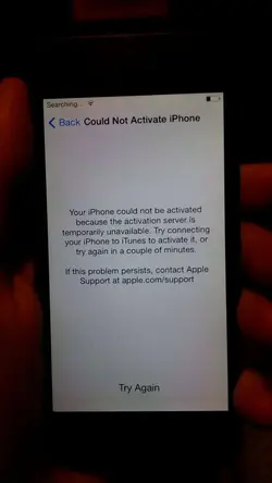

I have IPhone 5 A1429, and cant install new ios or restore with old in iTunes. when it gets to 60% stuck and shows error (1). There are some pictures. Help plsss. Thanks

its my friends phone he gave. when he gave me there was problem in sim card, it was stuck on searching, and without sim card, I didn't maked phone start, there was problem like that. I don't know which ios it was. and I downloaded iTunes and tried to restore phone but Error (1) in 60%. now when I start phone stuck in recovery/ (sory for bad English)

You can't install software that's not signed by Apple, thus error 3194. The only versions you'll be able to install right now, are 9.3.5, 10.0.1 or 10.0.2.
Error (-1) usually points to a hardware error.
