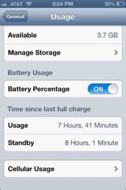

My phones about a year-old and I just don't seem to get anything out of battery $ImageUploadedByTapatalk1354787208.567844.jpg
This just can't be normal

If your Usage & Standby time are that close to each other... then you're on your phone constantly. 12hrs of Usage time is pretty darn good... regardless of how much Standby time is behind it.
Oh ok ya I don't put it down I don't have a PC or laptop so I do everything off the phone I'm also a long haul truck driver so I use it for work a lot so.... My batt time is on
Sent from my iPhone 4s using Tapatalkh. U ss
My only concern really... is that it says "No Service." Are you using your iPhone w/o a cellular connection?
Ya I out of Cellular range I have AT&T
Ah ok. Out of that 12hrs... what would you say you're using the most during that time? 3G internet, playing games, music?
I will reply with that after my full charge I'm doing now but I do charge the phone 2 to 3 times a day

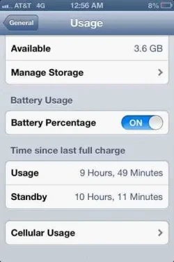

Last I don't know if this is good out not
