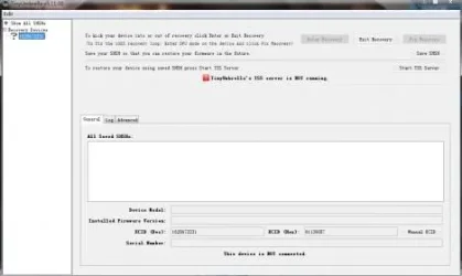

After I delete the system folder in IPhone, I can only enter into the recover mode instead of user interface. And when I try to do something with TinyUmbrella, it shows the following.

If that's the case, plug it into your computer and put it into DFU mode. TU should be able to recognize it. If it still does not, you'll probably have to manually input the ECID to connect to your iPhone. I'll give you instructions on how to do so if that's the case. From the screenshot, I assume you're running a copy of Windows OS?
