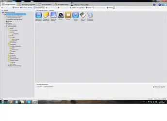

Im not sure i'm looking at the right place as my ifunbox is in french, i tried to pu iot in english but i didn't find where...
i did a search for the Setup.app but it didn't find it
$1.webp Where should it be?
i searched the setup.app everywhere and didn't found it...
