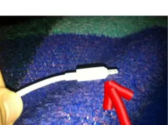

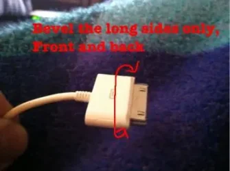

2. Problem - Charging cable not fitting into port on case.
Fix - Bevel the edges of the front and back of the cable end.
