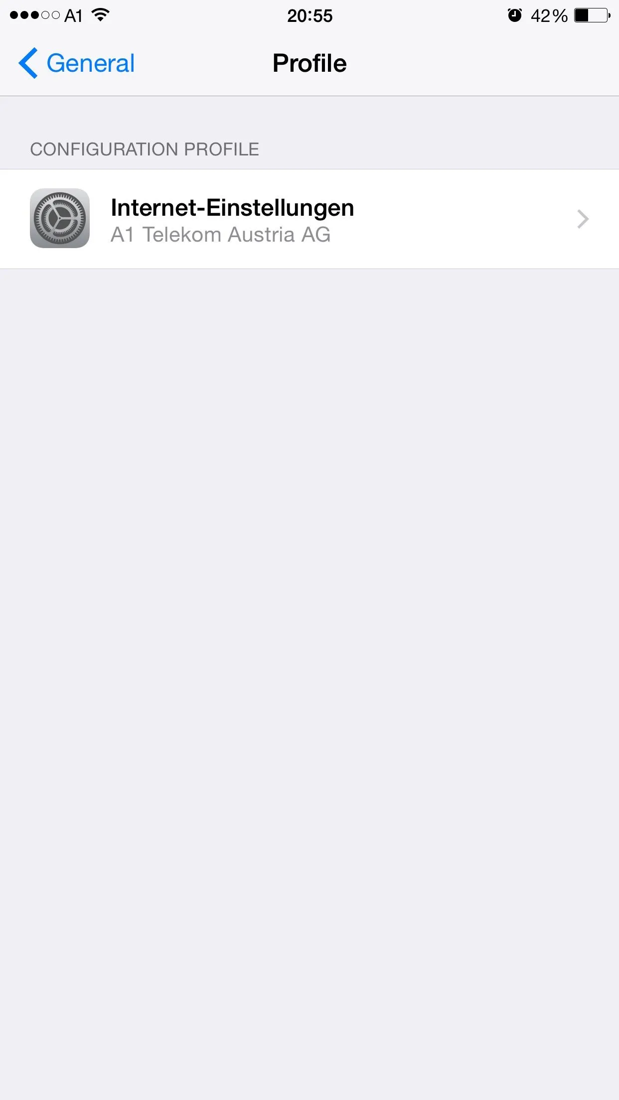

Is there a profile installed on your device? Look at Settings - General -Profile.
This one was installed by my carrier. It also sets up cellular data.

It's nice to read German one in a while :)I don't have the cellular data network button, but I found that I still have my German profile installed on my phone "O2 Post-Paid". Should I delete it?

You need the profile from AT & T there, maybe that's why it's not connecting. Delete the German profile.
Contact AT&T once more, so they can send you the link to install their profile.
