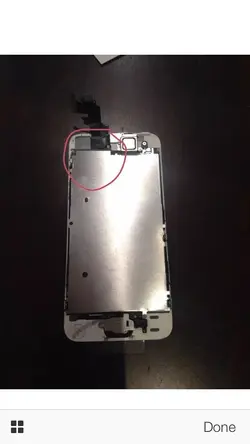

Thinking it might be something during the screen change or a part of the screen as it came with the ear speaker/light proximity sensor cable already assembled.
I did notice that on the new screen the had cut off the grounding cable that sticks to the back of the LCD screen. Ref picture

If the grounding cable is damaged on the replacement screen, that could be the cause of your problem. Does the phone work normally when Bluetooth is turned off?
Yeah it all works fine, the problem is only during Bluetooth phone calls. I can hear the other side or dailing tone either
Bluetooth music works fine too
You may have to have the screen replaced again for one with an intact grounding cable.
I've put my old screen back in but it still has the same problem. Looks like it wasn't the grounding cable going it.
