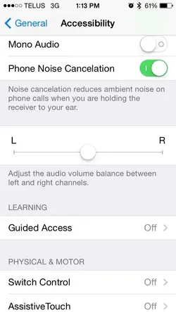

Check Settings/General/Accessibility and make sure the balance slider is set to central position.
Thanks for the reply,
Checked that, unfortunately it is in the centre
