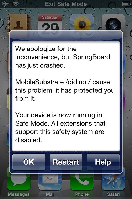

Automatic activation of Safe Mode.
From time to time you may find that your device resprings and safe mode is activated automatically. You will recognise this has happened because "Exit Safe Mode" will be visible in the status bar and a pop-up dialogue will appear explaining what has happened. You will also notice that because all JB tweaks have been temporarily disabled your springboard will look more like a stock device than a jailbroken one. Your icon layout is likely to be reset, icons may no longer be in the folders you expected, and the dock might be different (depending on how your device is customised).

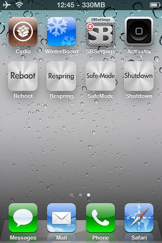

Safe Mode Launcher, PowerIcons, et. al.
A Cydia app which does exactly what it says on the tin! Installing this app will put an icon on your springboard which will enable Safe Mode for you. Very handy. Just be aware that sometimes, depending on the severity of the problems you are facing, you may not be able to even get to your springboard to launch this app if it is installed, so don't rely on it as your only protection...
There are several other similar apps in Cydia which provide icons for you to click to get into safe mode as well as other functions, such as a reboot, e.g the "PowerIcons" app. All of these should be considered in the same category. Very useful, but not always accessible, depending on the error you are encountering. The following screenie shows the icons installed by the free "PowerIcons" app:

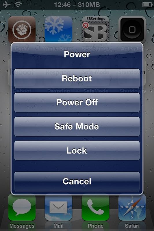

SBSettings.
Using SBSettings (normally from the lock screen) to get into Safe Mode is the most popular and easy way to get started with a basic level of protection. Make sure you allow SBSettings to be activated from the Lock Screen, bring it up with it's usual action (swipe across the status bar by default), choose the "Power" button on the right hand side, and choose "Safe Mode" from the pop-up menu. Your device will respring into Safe Mode.

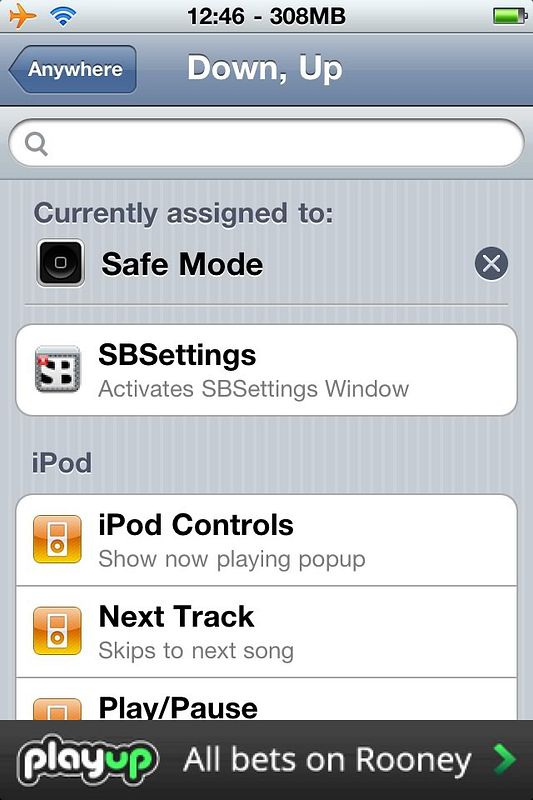

Activator.
Another popular method for the more savvy jailbreaker is to assign a specific Activator gesture to trigger Safe Mode when at the Lock Screen. This leaves you free to choose the gesture you prefer. Just don't forget what you assigned it to once you have configured the Activator app!
