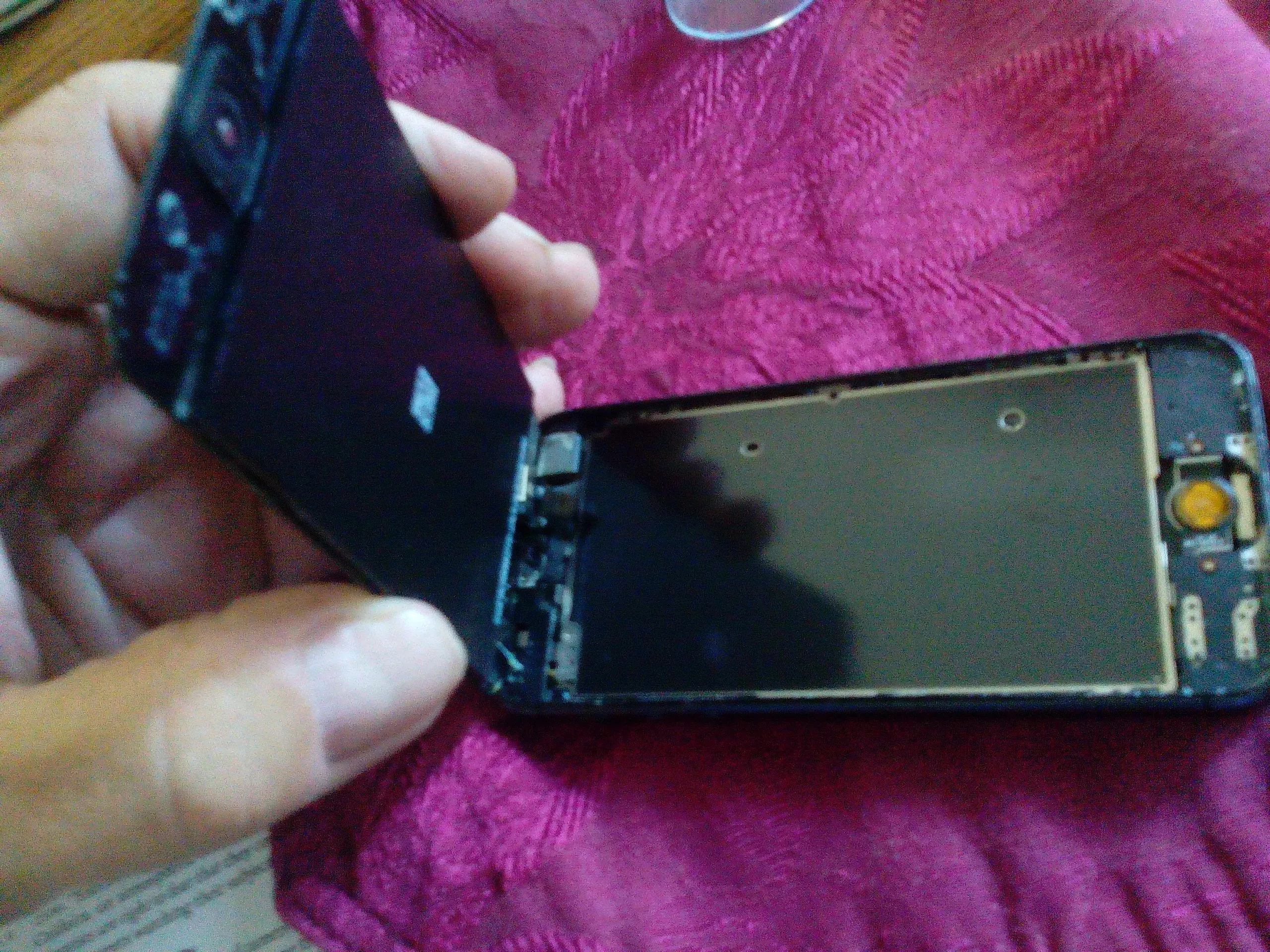

i just tried replacing my battery after watching a few videos on how easy it is to do. Ordered the battery and tool kit, opened iphone ok but it looks completely different inside from the videos. i put it back together for now and it is functioning. But wth? the model is A1429.
ive u\l a photo with the front cover open.
let me know what is going on here. Did verizon sell me a knockoff?

I edited my first post and uploaded 2 photos. I see them both with my Android tablet and my iPhone. You can't see them?

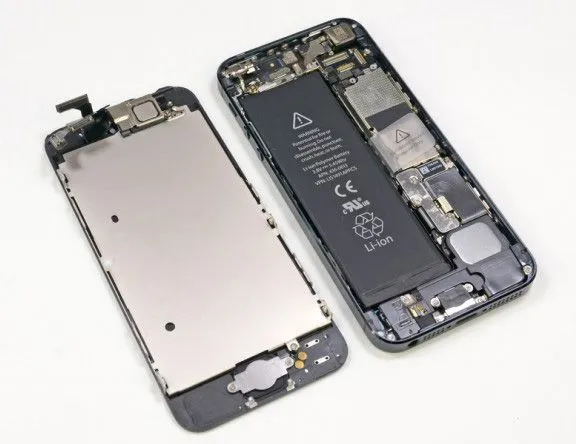

It looks like the metal shield assembly and the bit below it that contains the home button assembly that are supposed to be fastened to the back of the screen have become separated from it and are resting on top of the internal components in the back case. There are supposed to be screws fastening the shield assembly and home button assembly to the back of the screen.
Here's a photo of how it's supposed to look like along with your second photo.

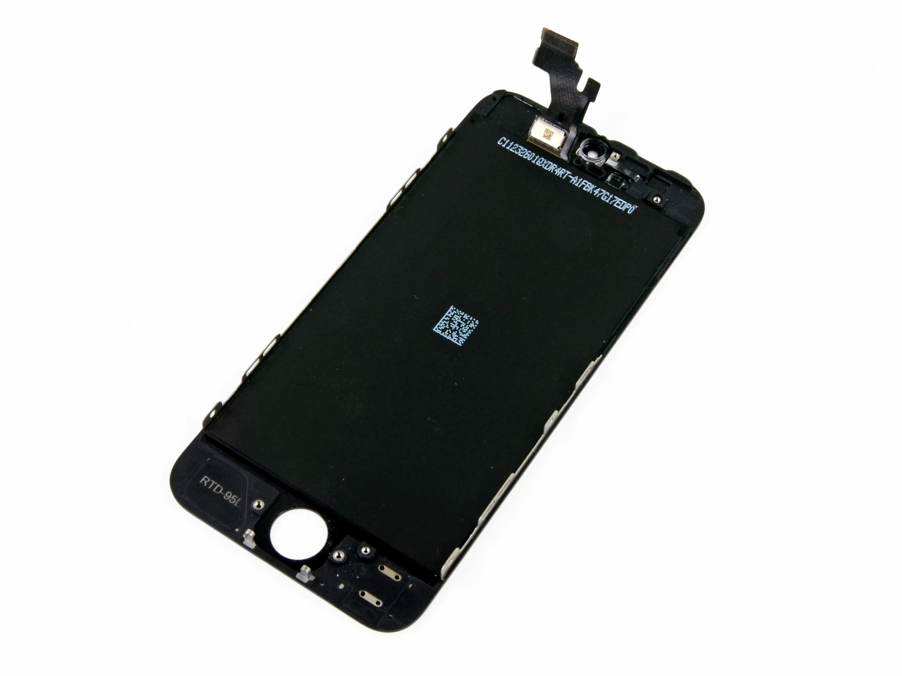

Here's what the screen looks like without the shield assembly and home button assembly attached.
I believe this is what your screen looks like when you lift it from the rear case.
View attachment 21622 View attachment 21623
You are correct. I had to pry up that cover, with more force than I was comfortable with but it did finally come up and I replaced the battery. Now I am having difficulty getting is snapped back into place. I have it somewhat together and working but the face cover is not fully in place. I will reopen it later and see if I need to forceably push that cover panel into place.
Definitely not as easy as the videos portrait it.
