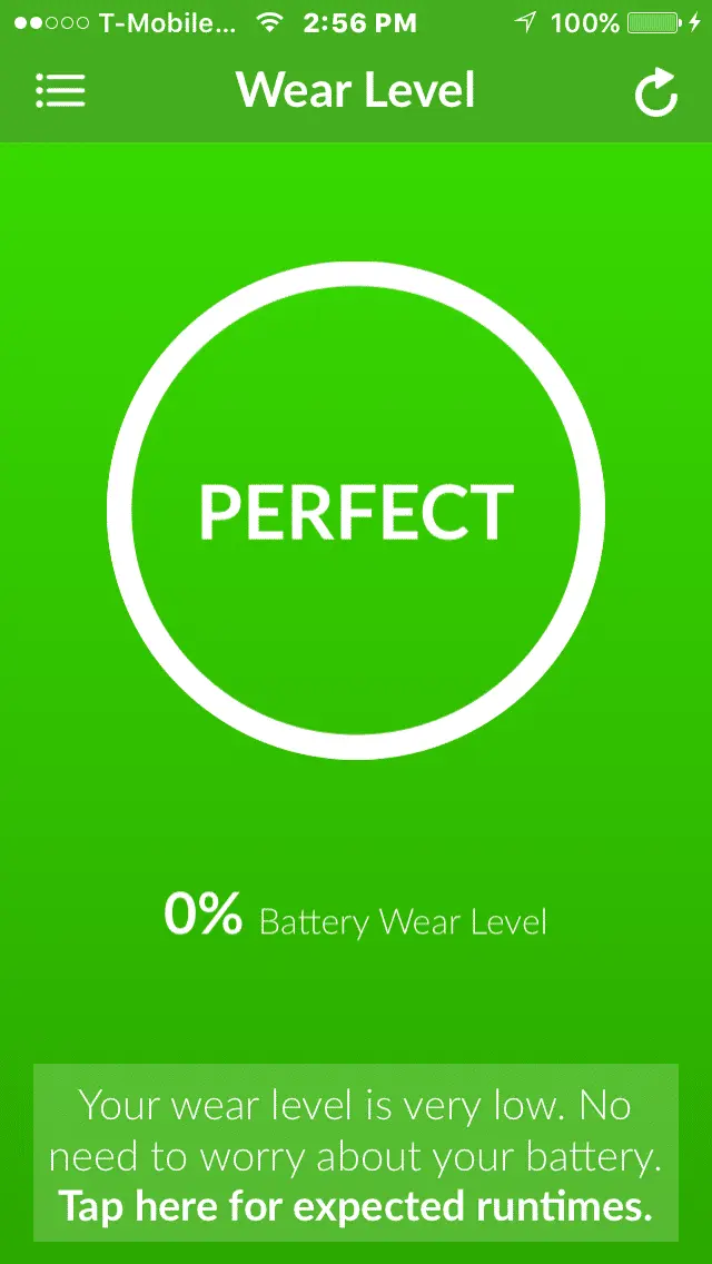

If I use my iPhone SE 64 gb for what is average for me (not as much as most probably but for my needs) it will last about 2.5 days. If I didn't use it at all but left it on using WiFi Calling or 4G LTE I think it would run a week. So about what it's advertised for I think. 3G will use more than 4G LTE. If your signal level is low, switching to a carrier that gives you a stronger signal will help significantly. Another important thing is to only allow the apps that really need it to use Background App Refresh. Then only allow apps to use location services "While Using The App". Very few apps need location services all the time. Unless you need it, keep Bluetooth off. WiFi uses less power than mobile data so use it when you can. 28% (Whatsapp) is a lot of power drain. Chat apps need Background App Refresh on to be able to receive calls, and I have several, but none use anything like that amount. Perhaps you are on Whatsapp a lot. Chat apps, when in use, are battery hogs. I avoid long chats using my iPhone for that reason. If you think your battery may be failing, get Battery Life from the app store. It will show you whether your battery is good and how good. I've had mine for nearly a year and it still says perfect. Reboot your iPhone now and then after you've installed several apps or had quite a few app updates. I do mine about once a month. Don't "kill" apps running in the background. They are frozen, not really running and killing them wastes power. Don't use "app killers" either. Modern mobile OSes (especially iOS) handle closed down apps better than you can and more efficiently. Use static "wallpaper" not dynamic. Colors don't matter because the SE uses a LCD display. Phones that do use OLED displays (it's coming to iPhone I hear, sadly) need a lot of black to save power used by the screen, but current iPhones are fine with any colors. There are probably more things but that's all I can think of for now. I'm a battery fanatic so I try to get all the "mileage" I can.

Tried battery life and it shows 8% wear. Is that normal in a 1 year old iphone?
Seems a lot to me, unless you're a heavy user. I've had mine a year and it's still 100% of original capacity. Do you use yours a lot and/or use heavy drawing apps? I try to be careful. 8% won't get you warantee service though. Apple says it's good as long as it's still got 80%. Also, I look at app reviews and if anyone says it's a battery hog, it doesn't get on my iPhone.
Edit: However, I do not think that a reduction of only 8% would be enough to hardly notice. I am careful with mine, so perhaps an 8% reduction after a year is typical. I normally charge mine when it gets close to 20%. Apple says that's OK but charging it sooner is also fine.
Hmmm... My "new, open box" iPhone 6S, which looks to in fact be new, as it has not a sign of wear on it, showed 13%, then 18% wear.

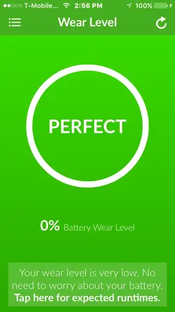

How are you showing battery wear? The only way I have ever done it is by having Apple run a diagnostic and asking them to check battery wear. Also.
Battery Life app
