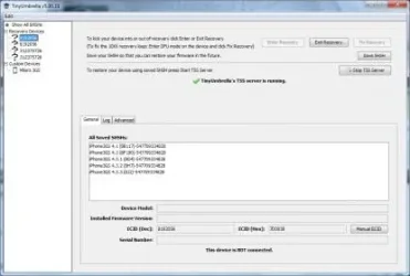

I used that to manually enter that number in tiny umbrella. This returned 5 SHSH blobs.
4.1
4.3
4.3.1
4.3.2
4.3.3
This surprised me. I did not unlock this phone myself, but I have never upgraded it, so I am not sure why it shows 5 blobs.
I also get these shsh displayed listed for a recovery device each time I try to restore in itunes. I have attached a screenshot of TU window.
