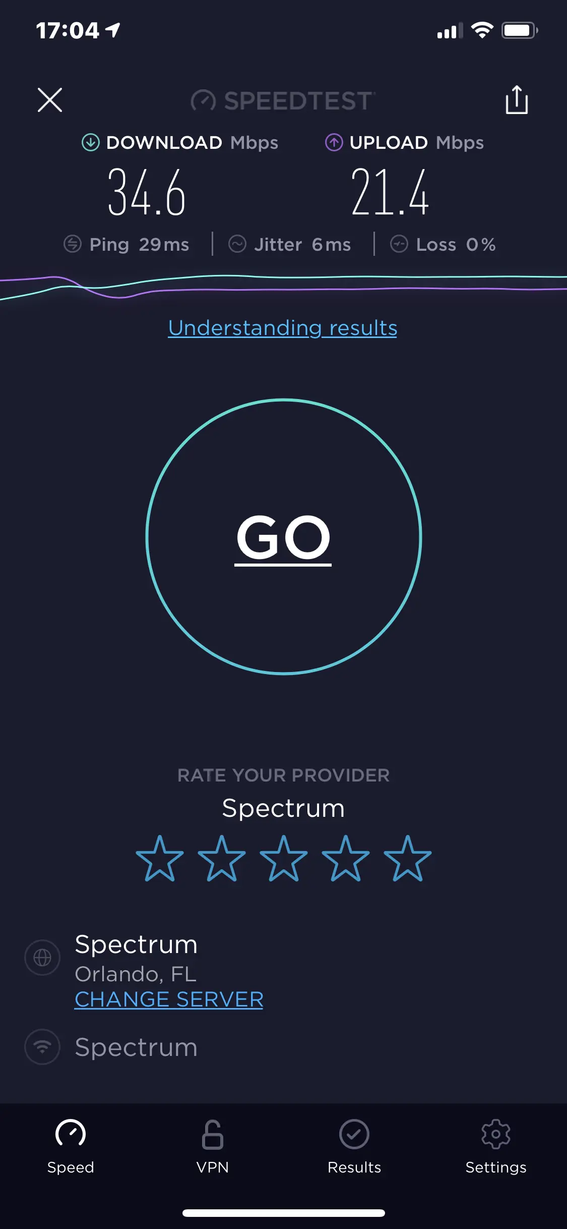

    I have 4 computers (iPad Pro, MS SurfaceGO, two HP G71-340 laptops, an iPhone 11 and a Galaxy6 phone in my home all using a Spectrum modem and router (replaced two days ago by Spectrum to fix problem, but didn't) Rarely are two of these using the connection at the same time, and very rarely downloading anything. Distance from any one of them to router location is less than 40'. Incoming Spectrum signal at the modem is 110+ Mbps. At one HP its download speed is consistently over 100 Mbps and the other is consistently about 38 Mbps. The iPad Pro is consistently over 100 and the iPhone 11 is always in mid 20's Mbps.(the last three are sitting together on my desk.) What can I do or look for that will speed up the slow ones, and why the wide differences?

    And the problem continues, with a variation on the iPhone rising to 42 and 37 on consecutive checks. The HP varies fro 33 to 39. Such is expected. The iPhone 11 and iPad Pro and the HP are all nearly touching each other on my desk and about 15 feet from modem and router. Both were replaced by Spectrum 4 or 5 days ago when I noticed the slow speeds. Nothing changed after the new ones were installed. The iPad Pro is over 100 no matter where I try it, and the iPhone is slow everywhere. I recently moved to this place from another city so that is why I noticed these speeds. Thanks for your interest.

    Are you sure you are seeing the WiFi symbol up In the right top corner, next to your battery symbol, if not you aren’t connected to your WiFi.
    Next, make sure you are connected to the 5ghz WiFi and not the 2.4ghz as this is much slower as seen here in this pic.
    As seen above, the first pic is while using the 5ghz band of my WiFi, which is spectrum 200mbps service. The 2nd pic shows the same WiFi, but on the 2.4ghz band. Notice the speeds are much slower, as described by the OP.
    To the poster of this thread, look at your WiFi and make sure you are connected to the 5ghz band and not the 2.4ghz band of your WiFi. You may have to refresh your WiFi for it to come up, and you may also have to retype your password for it to connect to the 5ghz band. Good luck and, Hope you get it resolved.
