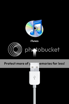

When your iPhone is in normal recovery mode you will see a graphic like this...
(remember, if you see this picture you are NOT in DFU mode)
