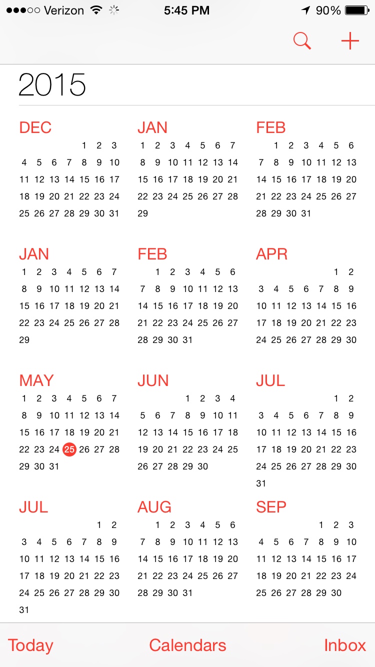

Hi.
I'm on iOS 8.4 and no I can't update due to software I must have at work.
Has anyone seen or know a way to correct missing dates and full months in the calendar app? I tried taking every app off and resetting everything, removing all linked mail/calendar accounts. That still did not fix it.

Did you try resetting all settings? How about restarting the iPhone by pressing and holding both the power and home buttons until the Apple logo appears, then release both buttons and wait for the iPhone to restart.
If nothing works, you may just have to live with the corrupted calendar app since you can't use the one solution that will almost certainly fix the problem; restoring the iPhone.
You could try a third party calendar app, if you can find one that does what you need.
Yep, tried all of that.
The only third party calendar app that seems to work is Moleskin; which doesn't make sense since it only pulls in the calendar.app. It doesn't make its own connections with the calendars.

I believe that the only way to get the calendar app on your iPhone working again is to restore your iPhone. I do not believe that there are any ways to fix it without a restore.
I'm missing something. You fail to state WHAT dates you are missing. The calendar spread is from Dec 2015 thru Sep 2016, since it shows May 21 (2016) as your current day.
Look at the months
Ok, this may or may not be what you need but it's an easy check. On your device (iPhone) Go to Settings>Mail,Contacts,Calendar>Sync. Check that you have All Events check marked. Hth
Thanks, but already tried that.
