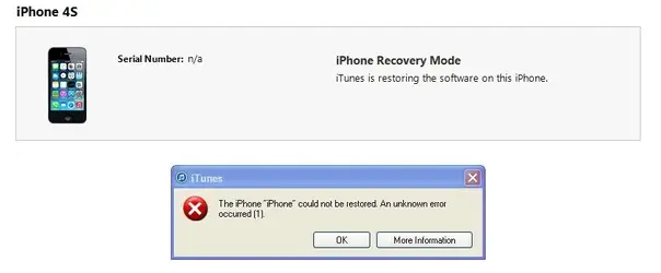

After a few minutes and what looked good itunes said unable to restore this iphone error 1 ?
Tried a couple of times now and no change at all also changed usb cable & used another usb port.

When i watch itunes i see the following.
EXTRACTING SOFTWARE
PREPAIRING FOR RESTORE
WAITING FOR IPHONE
VERIFYING IPHONE RESTORE
RESTORING IPHONE SOFTWARE
VERIFYING IPHONE SOFTWARE
RESTORING IPHONE FIRMWARE,,THIS IS WHEN I SEE THE ERROR MESSAGE.

Its strange i do not see the serial number on the itunes screen or the name of the phone on the itunes screen.
Strange after initial restore in itunes no carrier or network was shown on the phone.
I did make a backup file which is in itunes for this phone but i cant get to it because every time i connect the phone to itunes it tells me its in recovery mode,so i never get to select the back up file i made.
If i can put the back up file on the phone somehow then at least i can start it and show you screen shot etc where there is no name and network carrier.
