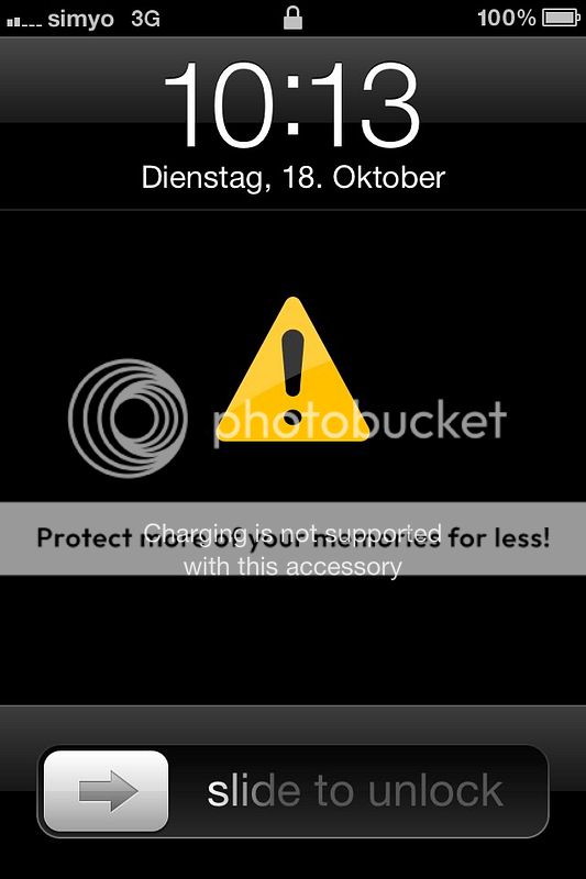

I have a Mophie Juice Pack Plus that was working fine on my iPhone 4 before I updated the OS to iOS5. After the update, I constantly get this:
Sent from my iPhone 4 using iPF.net
I think we can likely fix that error with a replacement juice pack plus -- assuming there isn't some unidentifiable quirk with how your phone completed the iOS 5 update.Fill out the technical support form at EDITED and one of our team will get you taken care of.

I will, but I feel the issue is with iOS5 and not the Juice Pack. :-)
