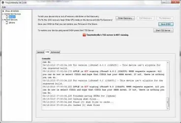

I have a question about saving blobs. I have never JB my phone, its an IP5 running 6.1.4. I know there isn't a JB for that firmware but I thought I would save the SHSH at least as a learning tool. I followed the tutorial and everything seems to work but no saved SHSHs appear in the list. The log says apple is no longer signing 6.1 SHSH requests anymore. Is that what I should be seeing? I'm a little fuzzy on that point. i thought the SHSH was on the device in the event I needed to do a restore or something.

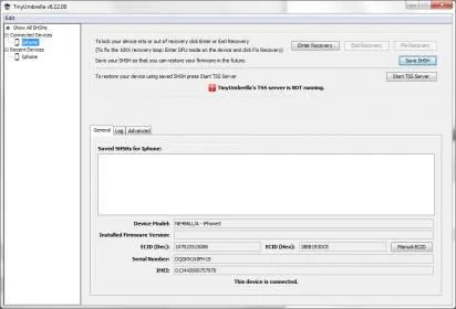

I have that unchecked and still no SHSHs saved. Here is what the log looks like and the list. Is that correct or should I be seeing something as saved?
That's what I thought. I must be ding something wrong because I'm not getting any blobs saved. It acts like its working though. I'll keep playing with it. Thanks.
That was the problem. Thanks for the help.
