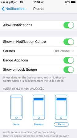

Which setting did you select in Notifications - Phone - Alert Style When Unlocked? The best choice would be Alerts. When you get a phone call, you have to do something (reject, accept), or else the notification won't go away.
Hi and thanks for the reply .
Yes I have it set on alerts .
This has only happened recently after updating to iOS 10 and it doesn't do it on every app.
I have tried re setting my phone and it still does it when I am on a app or internet or something , I just can't answer as the slider screen isn't there
Attached is a picture of my settings in the phone for alerts

When you're in an app, you don't get the slider screen. You get the Accept/Decline buttons when the iPhone is unlocked.
