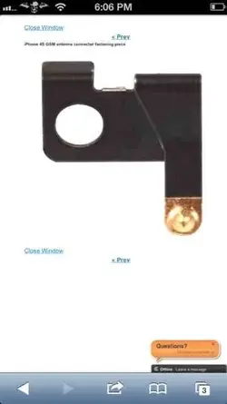

thank you so much thomas I found the part but I am still a little unsure how to fit it this is the exact part iPhone 4S GSM antenna connector fastening piece - original
I emailed them to see if they could give me a image or a better description on how to install this. If you have a image or could explain it to me "I'm a noob sorry" that would be great. Thank you again

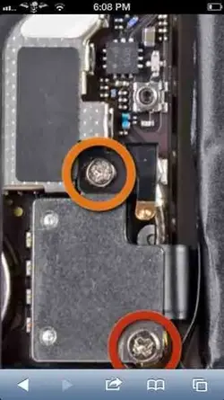

Mounts like this under the battery connector.... the top screw goes through the hole.
you are amazing I cant thank you enough a true iphone genious
