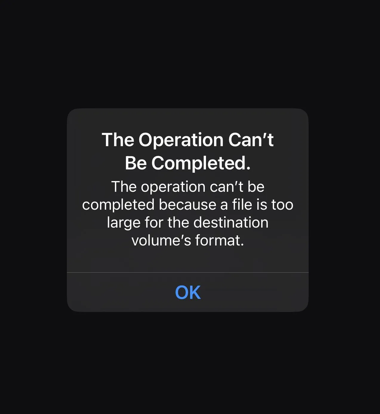

If I try to move a file from my 15 Pro Max to a flash drive, will the flash drive show up as an option?
@carolineM...ok. I see the flash drive in the Files app. Awesome!! So, how do I get my iMovie file (6.5 gig) on to the flash drive..
When I try to move the file to the flash drive, I get this message.
It’s an empty 8 Gig, so technically should be, but I’ll try a larger one and see. This isn’t formatted. Straight off of the shelf and into my 15 Pro Max. Thank you, CarolineM.

Thanks for your reply.
I was able to Share my phone iMovie project video to my iCloud Drive. From there, I downloaded the project to my computer desktop, into iMovie on the computer and export back to the desktop as an mp4 movie. Then load it onto a flash drive. All is good.
