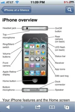

Here is a picture. The diagram shows 1 speaker.

Ok you realize that the receiver is a speaker? I'll see if I can find a decibel meter to close this mystery.

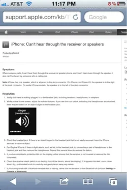

I understand that but it doesn't play music or You Tube videos as you claim. It is for calls and you can change the setting on Siri to work when you put it up to your ear. The iPhone has 1 speaker. As included in the picture from the manual and this from Apple's website. Just admit you were wrong it is ok to be incorrect sometimes! The Apple manual and website are correct. Enjoy listening to your music and videos from your 1 speaker located in the lower right hand corner.
