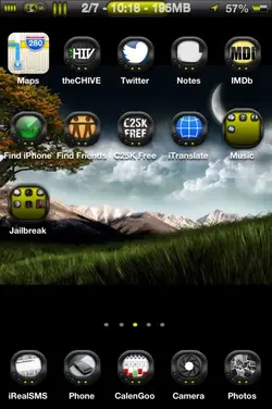

Here is my new layout.
Finally got one whole theme to work after hours of changing things through iFile

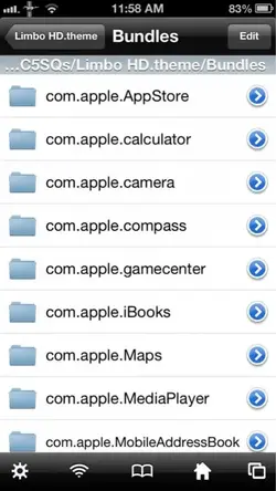

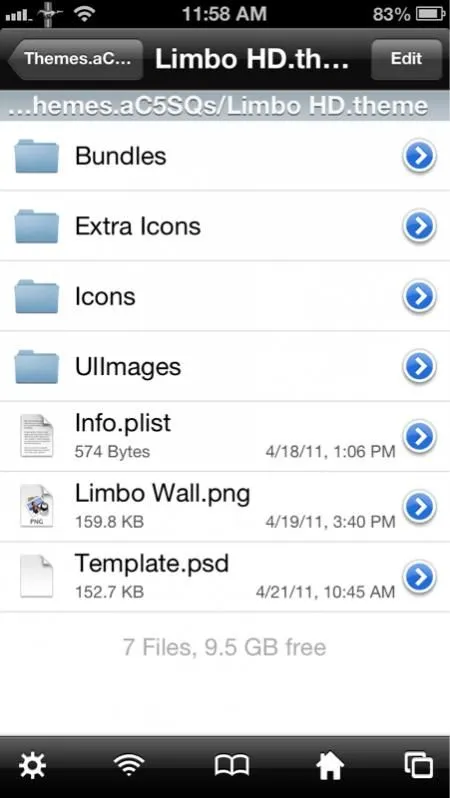

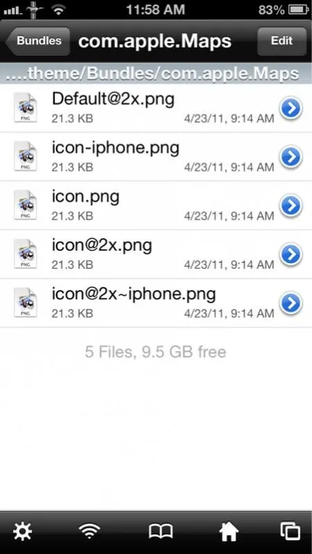

Ok under bundles you have to have a something like this
com.apple.maps
Then inside it has to look like this
When you edit the folder to look like this make sure you use the icon picture that the theme gives you, the icon pic should be somewhere in there. Once the bundle looks like this its set and then respring.

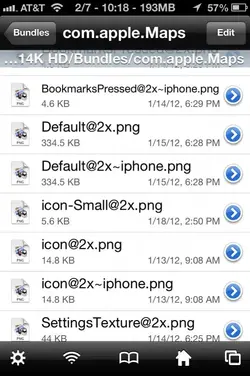

Frustrated. Ok, specs. iPhone 4S on iOS 6.1 running winterboard with summerboard off and 14K HD theme. Made the changes you mentioned (thank you) and still Maps icon is stock.
Here is what mine looks like and what area it's in. Seems like you may have a to much in that folder. Just make sure your mods are under com.apple.maps
