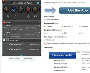

The website where I found the theme actually has very good documentation on which model of phone and version of iOS the theme is for.
<img src="http://www.iphoneforums.net/forum/attachment.php?attachmentid=13846"/>
I have searched google with word combinations that should show complaints about them and entered the web address into scam alert search engines. They seem legit and have lots of positive reviews. I know those can be faked but I've not found much negative so far. Their iPhone app is a very easy to use, has great previews of the themes and a handy feature to search themes by phone model and free or paid themes.
I have since discovered that iOS is themed with multiple file packages that are not always installed all at once and what I downloaded was actually only an add on for "Leg1on" to theme the notification center. I had been searching for that theme because it had made several top theme lists, I liked the pics and I wanted a free one for my first time. Just to get my feet wet. I think it used to be in Cydia under ModMyi.com but is gone now and even the devs links are dead.
