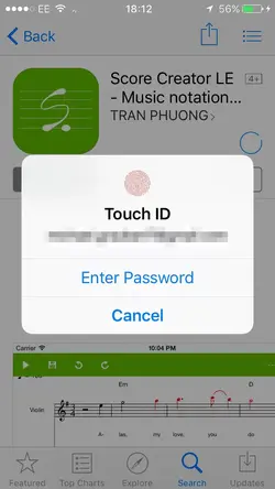

I'm afraid I have to return to the fray. I have enabled Touch ID in Settings both for unlocking and for the App and iTunes stores. My fingerprint unlocks the phone perfectly, but it seems not to work in the App Store. I attach a screenshot of what happens when I try to download and install an app.; I have tried touching everywhere on the screen with the finger with which I created the stored fingerprint, with no success. Once again I should be very grateful for help.
You have to tap the Home button with the finger that's registered, when you see this popup.
As with taking the fingerprint, the home button is the only fingerprint reader on your device.
If Touch ID is enabled for App Store purchases you have to touch the home button just as you would to unlock the phone. Also, if the iPhone has been restarted or has sat unused for too long, the password has to be entered to re-enable Touch ID.
