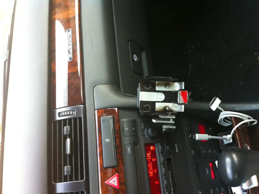

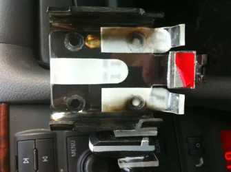

I ended up making my own out of plexiglass. Just heat up the plexi with a heat gun or torch lighter (regular lighter turns the plexi black) and then bend it into the shape you want.
The first one I made was for my 1st Gen Nano. I was able to just drop the Nano (with it's case on) into the mount which guided it onto the Aux cable and charging cable fixed on the mount.
Since this I have made my own mounts for 2 3g's and my 4. I also incorporated a bluetooth headset holder onto each of the phone mounts. Each of these mounts has had a fixed power cable that the phone just slid onto.
I used the ProClip brackets to attach the mounts to my car because they are easy to install and remove without damaging the car.

Matth3w: I will take some quick ones of my temp one and post them soon. I'm in the middle of building a new holder that will also hold my Nano and Richard Solo 1800 spare battery.
Here's a couple quick pics of the temp holder..
This one is being held on by command release strips whereas the final version will be mounted some recessed screws. This one also doesn't have the 30-pin connector permanently mounted ... but the rough support for it is there.
