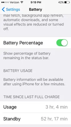

Suddenly Battery doesn't list usage by app in last 7 days or 24 hours

Same behavior with iPhone 6 and iPhone 5s all on 9.0.2
Works fine on my iPad Air
Here it is
cid:A9EEAFC0-9455-40FF-ADB9-ED3ECC693CEB
How about this
I can't tell from the picture. Have you got Low Power Mode enabled? I would try a reboot of your iPhone. If this doesn't correct perhaps you need to download the iOS from iTunes rather than over the air. Perhaps someone with greater knowledge than I has the answer. Good luck.
I just looked closer at the picture. It says it will show after using the iPhone for a few minutes. Unplug and use it and check again. That could be it.
I waited a long time and nothing happens.
It wasn't connected and I have Low Power Mode enabled but when I took the picture it hadn't kicked in because there was enough power.
I rebooted and no difference.
Was down from 42 to 18% at 2:00 PM today without any use at all.
Had just recently worked.
Reboot and charge your phone. Then unplug and check.
A Google search shows that using Reset All Settings makes it work again but I would. Ack up my iPhone before trying that last resort.
I did and no change. See that 9.1 now available, wonder if this changes. Normally I don't like to upgrade immediately.
Mine looks exactly the same as yours.
In any case I would update to 9.1. You shouldn't have any issues with it.
Updated to 9.1 Short test and seems fine.
Had a long FaceTime session and sure enough, usage by app was there as I expected it. It wasn't on my iPad, that I hadn't used.
Thanks for the help
