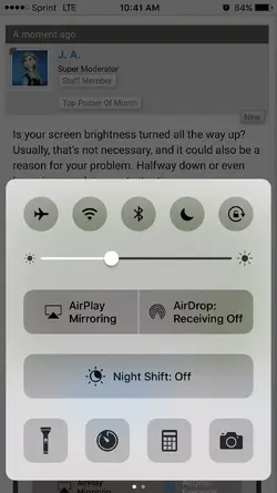

Is your screen brightness turned all the way up? Usually, that's not necessary, and it could also be a reason for your problem. Halfway down or even lower is enough in most situations.
I keep mine like this, except when I'm outdoors:

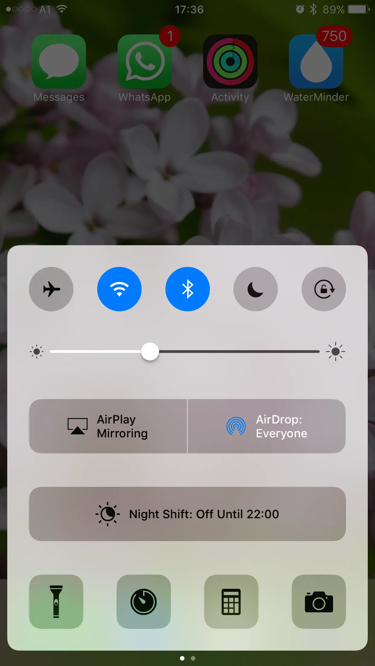

Mine is like yours, not all the way up. I usually have mine on auto adjustment.
I've turned that off. That feature tends to make my screen too bright, and my device is getting warmer than necessary.
