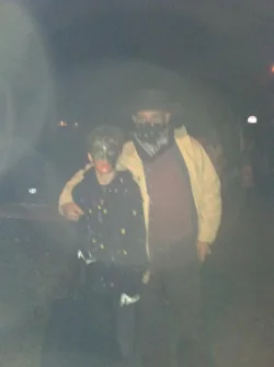

Missed so many good shots trick or treating last night, as anytime i take photos at night, they are blurry with a greyish light tone to them? Any ideas how to fix that?
Have a new Iphone..but had same issue with night pics on my other one! Frustrating....i switched from auto, on, off in flash..same prob (well flash off they were just totally dark..)

Im using the built in camera..no movement as it was alot of posed pictures...i have a cheap case on it..but that means i need to take the case off every time i want to take pics??
your hands were moving, that is part of the blurry part. you can see that movement in the lights behind the people. Those large circles are reflections of the flash off the case. It looks like the case may cover the lense and/or the flash. get a better case, or no case.
well the subject and I were standing still..i never have the problem in daylight pics. The lense/flash dont seem obstructed...but maybe thats it..can't afford a "good case"....
the lighting in the background shows the camera was moving slightly when the shutter closed.
Looks like you may have to run without a case for night shots.

Ok, that case has the camera/flash cutout way to "tight" or "close" around it. So when the flash goes off, the edge of the case (which looks at least to be 2 to 3 millimeters thick) will reflect the light and bounce it towards the lens. The lens is actually expecting the light source to be coming from straight ahead. But this "off angle" light is coming in almost flat from the side and at a very high intensity. The CCD (camera's eye) tries to process it along with the rest of the light that it is seeing. And if you look really close, the majority of the "light bubbles" are on the left side of the photo which is where the flash is positioned.
When you get a chance, you should take a picture with basically the same night condition with the case on and off. Odds are the picture is going to clean up really well with the case off.

I experienced a corner flash flare with my iPhone5 in an Otterbox Defender case. Happened in a dark setting. The opening seems adequate, but it picks up a vicinity reflection from the case thickness. Removed case, works fine. Going to try a matte to absorb incident reflection.
