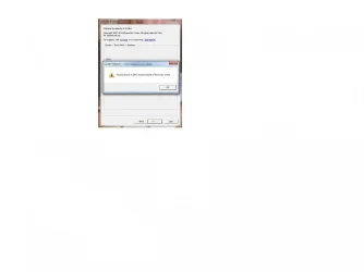

I can put it in recovery mode dfu mode and pwned dfu mode, i tried to use recovery fix in redsn0w but at the end it says missing keys.plist for this build
i went into redsn0w extras even more restore and then i chose my ispw and chose remote for blobs it was uploading iBSS and it was almost done then it said error found device in dfu mode instead of recovery mode i was in pwned dfu mode when i tried this

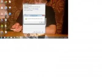

Did the restore ever actually progress in iTunes? Or did you just get slammed with errors
the restore did progress, twice, yestarday and today, it stayed at the tiniest little bit on the phone for 10 hours with the apple logo and progress bar not exaggerating this, i got home at 3 and by 1 in the morning it was at the same spot, same for today except i got home at around noon and stopped it by putting it recovery mode after about 8 hours. I stopped it both times with recovery mode
This is what redsn0w says i still don't know why it is calling my iPhone VZW which i'm guessing stands for verizon even though i have sprint maybe because sprint recently got the iPhone?
Based on the last time this iPhone 4-VZW connected in DFU mode:
CPID: 8930
CPRV: 20
CPFM: 03
SCEP: 01
BDID: 06
ECID: 000001E108130D88
IBFL: 00
SRTG: [iBoot-574.4]

i just tried to restore with redsn0w in dfu it automatically put me in pwned dfu mode when i start the restore it says uploading iBSS then it says uploading iBEC then redsn0w says found device in dfu mode instead of recovery mode

just did a normal restore in itunes and a progress bar popped up under the apple logo with that little bit of progress my guess is it will stay like this until i enter recovery mode?
I hope your still up lol
i just got the -1 error in itunes and are now back to recovery mode again lol
